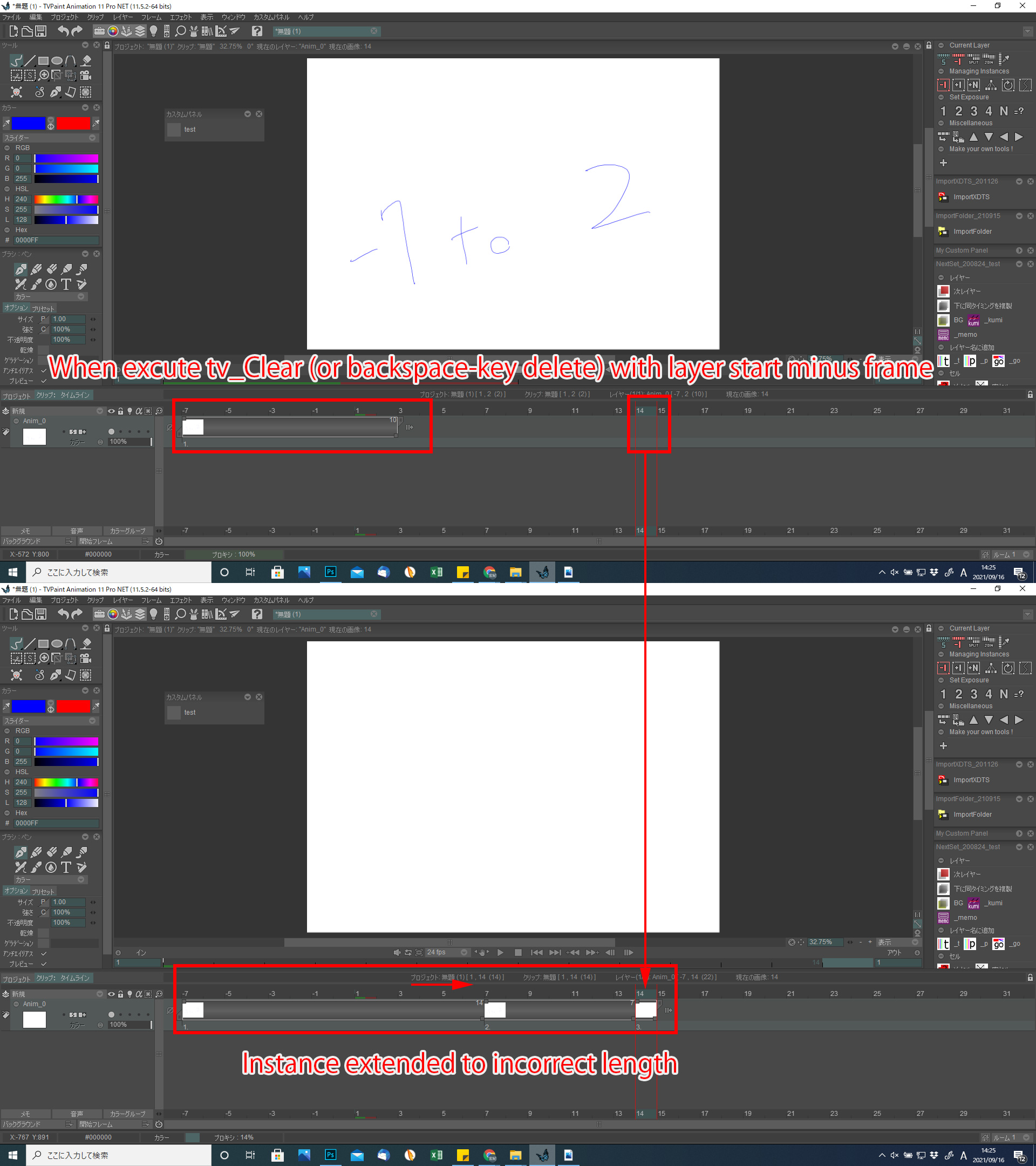

I reporte a bug when we created a custom panel in our studio that "creates an empty instance and names it instance name 0".
-When using a minus frame on the timeline, if the instance is cleared with an empty frame (tv_Clear command or manually layer: clear), the length of the previous instance is not correct.
The importance is not so high, but please consider it.

I recorded the occurrence of this bug on a video.
- 210924_to_Thierry.mp4
- (2.65 MiB) Downloaded 775 times
Re: Instance clear (tv_Clear) bug when using minus frames on the timeline
Thank you for the video, we managed to reproduce it.
I'll add it to the list (but I cannot guarantee it will be fixed for v11.5.3).
