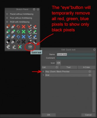

Re: Quick view of drawing area as values (grayscale, b+w)
Hi John,
Go back and look at my original post where I just modified the embedded GEORGE script. Notice that your path is now hardwired so it could be assigned to a variable so that the entire path could then be enclosed in single-double-single quote sets (' " ').

NathanOtano wrote: ↑26 Sep 2021, 14:43 =
For your purpose i’d just use a button to convert in grey scale as you want and then use undo, which is close to your use of fx stack and I think is the optimal version (you can even use a shortcut to toggle fx stack preview on and off if it exists?
I remember a toggle to see momentarily only some colors in the sketch panel , maybe you can try to see how it works? It’s a little eye
The little eye button is in the Sketch Panel. It will temporarily hide red, green, or blue pixels and show only black pixels. It is a keyboard shortcut called "Black Preview".
I don't know how it could be tweaked to convert color to greyscale , but that button might contain a clue ? I'm only chiming in here to mention the location of the little eye button, I don’t have any idea how to adapt it or show greyscale only.
