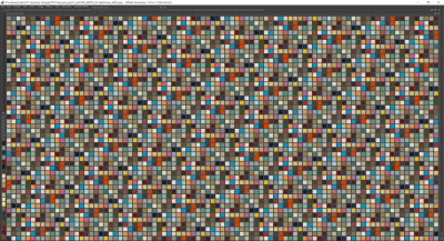

i don't know if there is a max but i know you can add quite a few...
this one is 135 Mb and is just a colorpalette (so no heavy brushes etc...)
i copy pasted a number of times just to test if there was a limit...
but it loads ands saves without issue

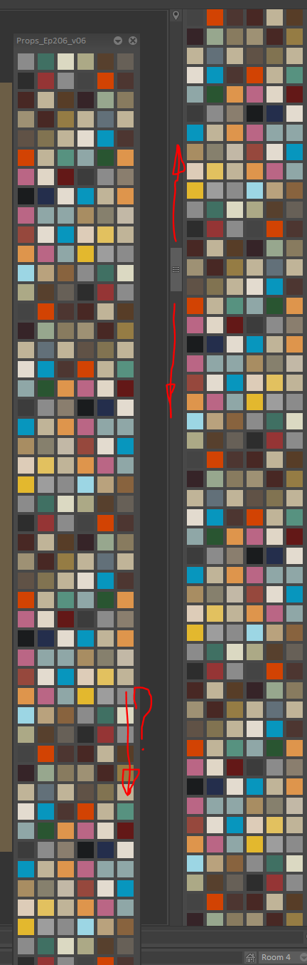

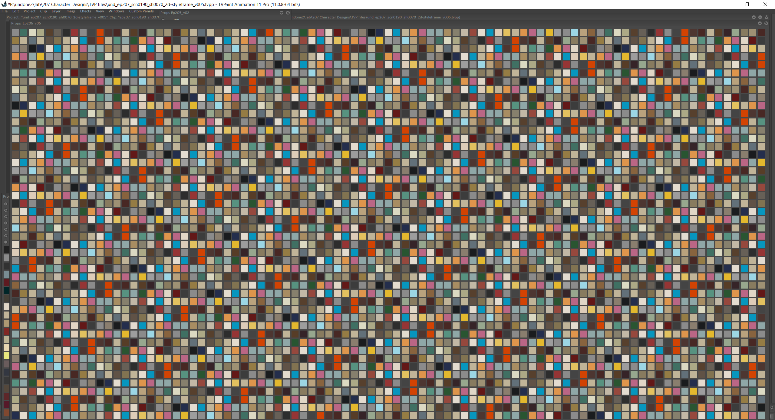

One limit of the custompanel is when it becomes so long
that you cannot acces the buttons outside of the screen, because there is no slider!
so it has a UI limitation.
this example is off course a bit silly:
but in a more realistic scenario...
when you create a vertical panel that is longer then the screen is high, you cannot acces them if the panel is outside of the screen.
narrowed down, you need to dock to be able to unlock the lower action buttons:
