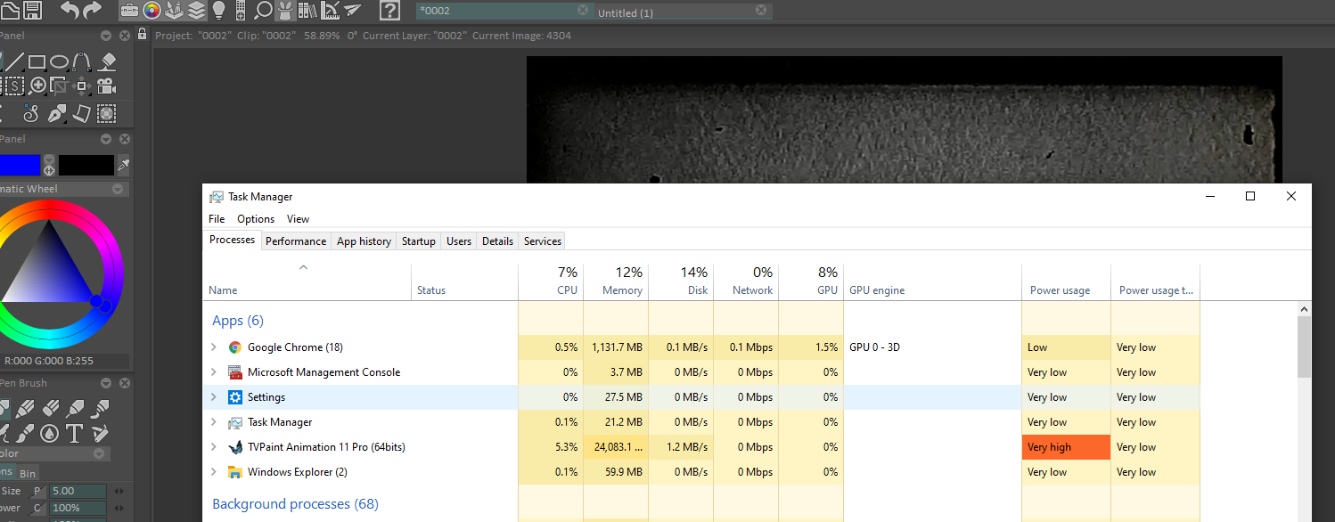

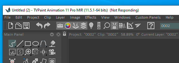

Hi there,
I've just moved to a new machine with these specs:
2 x XEON E5 processors
256GB RAM (that's correct)
Windows 10 Pro
Cache set to a separate SSD from the drive the app is running from.
Cache size set to 2GB manually.
Doing the simplest of processes, it is running slowly, and constantly presents the "Not Responding" message in the Window's top bar. See attached image. Here's CPU usage while this is running. Maxes out at 6 to 7% This is not unique to this new machine. I've routinely seen this on my earlier machine. It is like it is timing out. I have music playing and am creating this message at the same time I'm waiting for a image flip to render = FX > MOTION > Y Scale -100
Nothing else is stuttering or timing out while TVPaint is.
Any thoughts?
Thanks as always?
Casey

Hi, I updated your posts to attach the pictures, because I wasn't able to see them.pixelpusher wrote: ↑17 May 2021, 23:23 Doing the simplest of processes, it is running slowly, and constantly presents the "Not Responding" message in the Window's top bar. See attached image.
Indeed, this is weird. Not only the "not responding message" but also the power use.
Given that you have a MIR dongle, it's particular though. I'd suspect a hardware failure in your dongle or the port where you plugged it.

Your TVPaint seems to be taking an insane amount of RAM, may I ask you to post the specs of the project you were working on, please? :p
