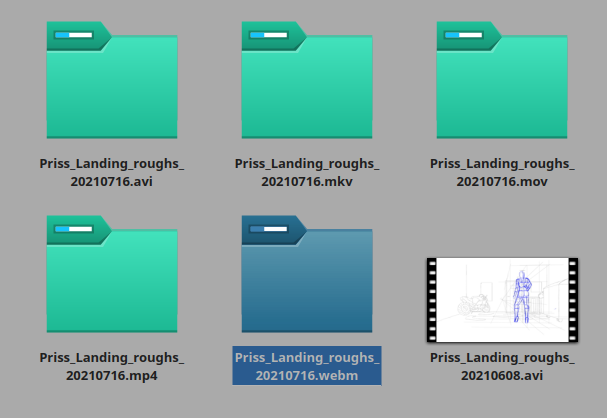

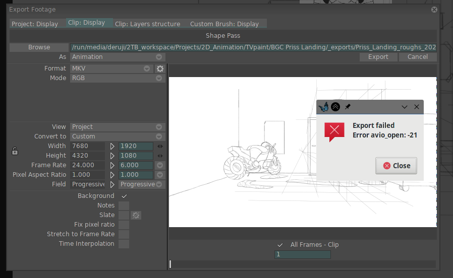

I am also experiencing issues with exports on Linux i.e. TVpaint export fails with video and images. The exporter seems to be creating folders named after the filename instead of creating the final files.
As far as I have tested it fails immediately when exporting .avi; it begins export of other formats such as .mkv, but then fails. Changing resolution and framerate has no effect. This is in addition to the wrong format message I keep getting as well.

I reinstalled TVpaint Pro 11.5.2 just to be sure, but the issue remains. I don't have access to 11.5.1 to revert.

Something in the layer structure seems to have interfered with the export settings.
After selecting back and forth between different formats im the structure tab the issue seems to have resolved itself. I'll keep an eye on this for a while.

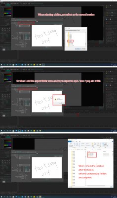

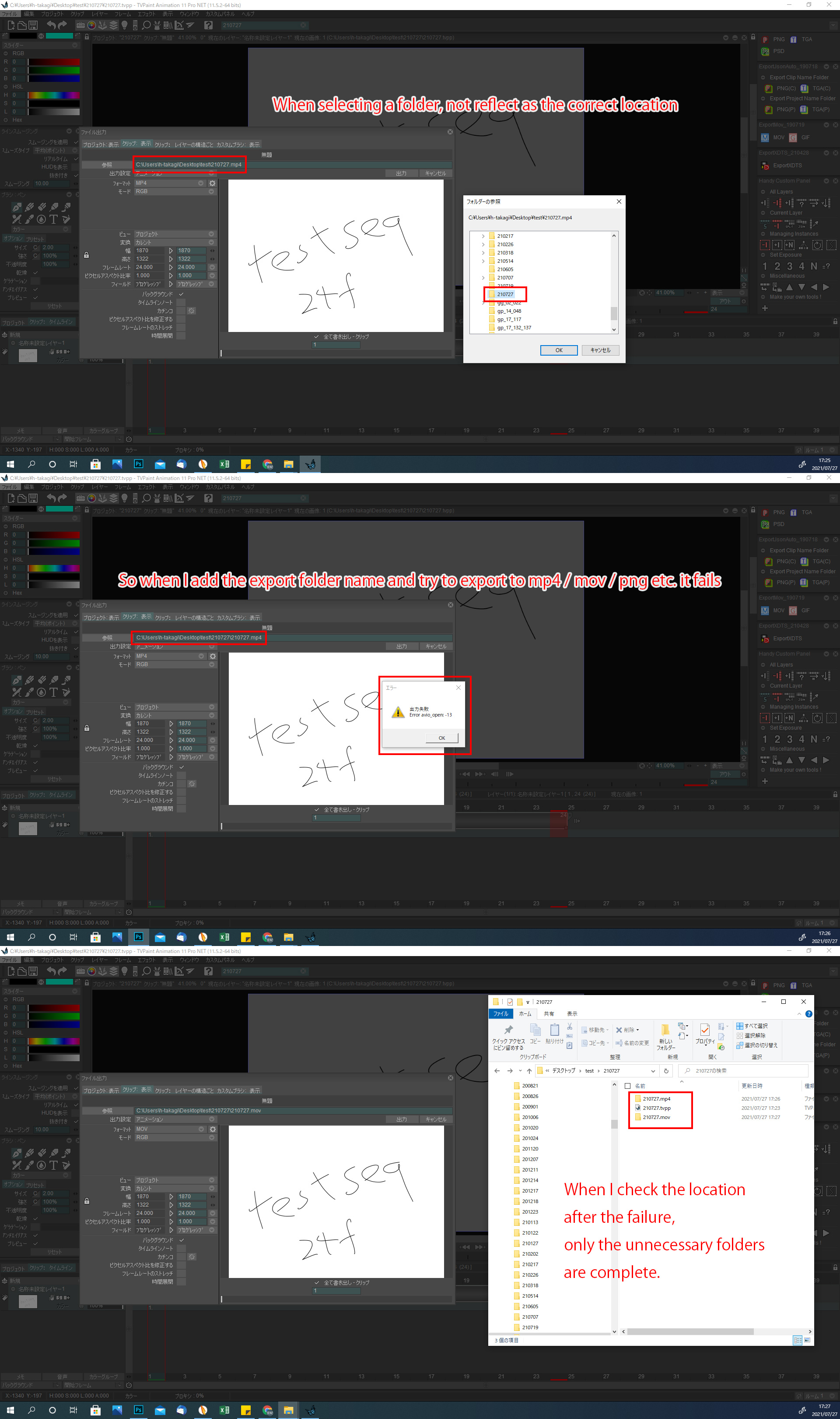

I was wondering if I should set up another topic, but I will post it here.
I'm aware that there is a problem with the TVPaint 11.5.2 export itself.
-The path specified in the file requester is not valid.
-Cannot export correctly even if the path is corrected
Is it possible to solve it?
[postscript]
I was able to confirm that it was solved by updating the settings.
However, it is not realistic to operate to update everyone's config in our studio with a large number of users.
Currently our studio does not have the latest version to use safely and continues to use 11.0.8.

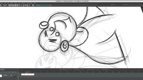

Hello! Not sure if this is the correct place to post this. I've noticed that the last two updates for Wacom drivers are causing the pen to stick, freeze the program and cause severe lag when zoomed in on iMac/Cintiq 24 Pro. I had to constantly reset the zoom with the navigator tool. The eraser on the pen would causes the same problem. I wanted to update to the latest Wacom driver due to the pen fix for Autodesk Maya Driver 6.3.43-3 (macOS 10.13 - 11) - 109 MB 5/18/2021. I rolled back to---Driver 6.3.41-2 (macOS 10.13 - 11) - 97.2 MB 10/6/2020 and so far all is working well. Sorry if I put this post in the wrong place or its not clear. Hopefully this problem can be solved or reproduced on your end for investigation. Thank you for your time and advice. BTW A Json Importer for TVPaint to Autodesk Maya would be incredible if possible too! :D Thanks again!!!
Specs: iMac 2017-- 4.2 GHz Quad-Core Intel Core i7---64 GB 2400 MHz DDR4---Radeon Pro 575 4 GB---OS Big Sur 11.4
Chillrobski
Posts: 23
Joined: 22 Oct 2014, 23:07
Re: downgrade to TVP 11.5.1
Post by Chillrobski »
