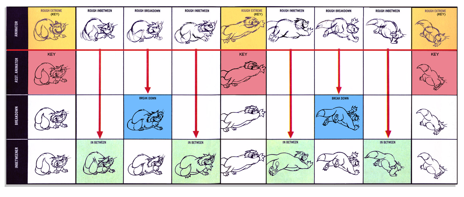

In traditional hand drawn animation, we have drawings designated as KEY drawings, BREAKDOWN drawings, and INBETWEEN drawings. (some animators use the designation EXTREME rather than KEY. In common usage I find that most animation artists treat the words KEY and EXTREME as synonymous. For our purposes I'm going to use the terms KEY, BREAKDOWN, INBETWEEN , because the term "KEY" is already embedded in TVPaint's nomenclature in the Image Marks and Flips panel)
(click image to view it larger)
KEYS: The most important drawings or extreme poses in a scene that establish the essence of the action and performance.
BREAKDOWNS: The main drawings or positions made between two keys, which define how a character transitions from one key pose to the next key pose.
INBETWEENS: The drawings that fill in the action between the keys and breakdowns.

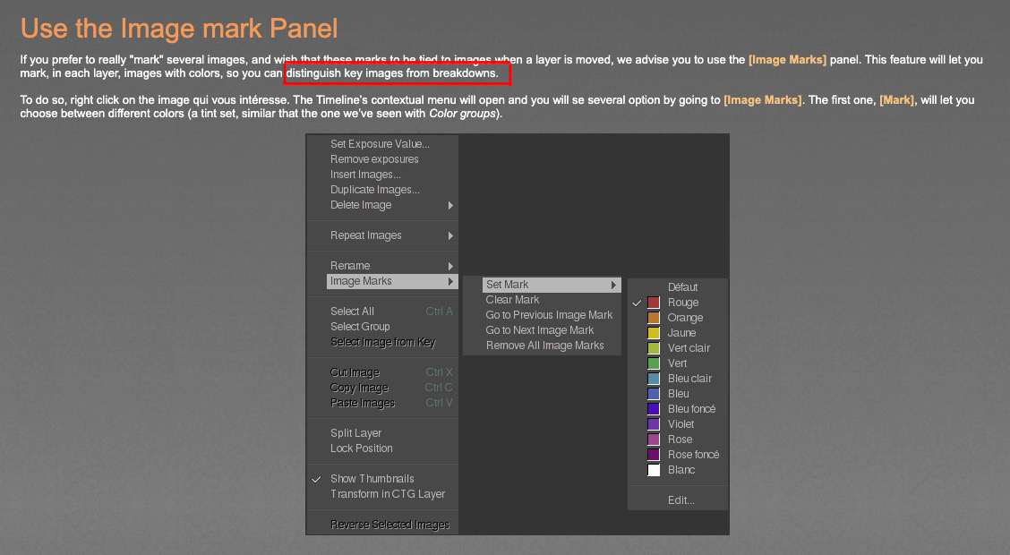

Because when you are using the Image Marks and Flips , the very same term ("KEY") is used to refer to Key drawings. Also shortcuts for LightTable : Edit Next Key and LightTable: Edit Previous Key have to do with Key drawings , not with Keyframes , but the current shortcuts terminology is using Key to refer to both drawings and keyframes , which are not the same thing.

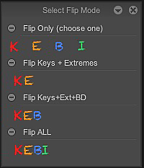

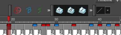

Thinking again about the distinction between Keys vs. Extremes , one thing I prefer about TVPaint's system of color marking is that there are more than only three colors to mark drawings. (with Harmony you get Red for Keys, Blue for Breakdowns, Green , or no color, for marking Inbetweens) . With TVPaint it could be something like Red = KEYS , Orange = Extremes , Blue = Breakdowns , Green , or no color, = Inbetweens . Flips preferences can be set up with keyboard shortcuts to flip between Red marks only (Keys only) , Red and Orange marks only (Keys and Extremes) , Red, Orange, Blue marks (Keys-Extremes and Breakdowns) , and Flip ALL (Red, Orange, Blue, Green) . And of course the colors denoting Key , Extreme, Breakdown , or Inbetween are up to the individual user , so if you wanted something other than Red, Orange, Blue , Green , you could use whatever colors in the Image Marks list that you prefer. So if you prefer, the Richard Williams system could be adhered to, not conflating Key and Extreme into a single category of "Key" drawing.
Something I do prefer about Harmony's system is that the same two Keyboard shortcuts F = Previous drawing G = Next drawing work for flipping Keys only , or Breakdowns only , or Keys + Breakdowns ,or Keys + Breakdowns + Inbetweens, depending on whether you have selected the K , B , or I buttons (or selected all buttons) on the Flip panel above the timeline . The selection of these buttons controls whether Next Drawing or Previous Drawing will jump from Key to Key or from Key to Breakdown , or flips all (if you have K, B, and I buttons all selected). This is nice to be able to have only two keys (F and G) to remember for Previous and Next.
Harmony -
Screen Shot 2021-05-03 at 10.50.17 AM.jpg (19.12 KiB) Viewed 15666 times
I hope that the NextGen version of TVPaint under development could have something like that ?
However, I also wonder if a similar arrangement could be made using George script with buttons in a Custom Panel ?
So by clicking on any single button in the first section (either K or E or B or I ) then the shortcut keys for Next Instance and Previous Instance would flip between only Keys or only Extremes or only Breakdowns or only Inbetweens .
By selecting the button KE under the secion Flip Keys + Extremes then Next Instance and Previous Instance shortcut would flip between only Keys and Extremes .
By selecting the button KEB Next Instance and Previous Instance shortcut would flip between Keys + Extremes + Breakdowns
By selecting the button KEBI Next Instance and Previous Instance shortcut would flip between Keys + Extremes + Breakdowns + Inbetweens (i.e. "Flip All")
A bit more cumbersome than Harmony's system, but I think this might be possible now in TVPaint 11.5 with use of George scripting (?). I don't know how to script , so maybe one of the resident scripting experts can chime in one that point.
