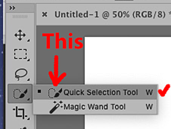

While we're talking about similarities between TVPaint and Photoshop, I would be very happy if TVPaint could add a Quick Selection tool like in Photoshop. Sometimes this Quick Selection Tool is much more efficient than the Magic Wand selection.
Screen Shot 2021-03-30 at 10.33.49 AM.jpg (57.28 KiB) Viewed 10860 times
