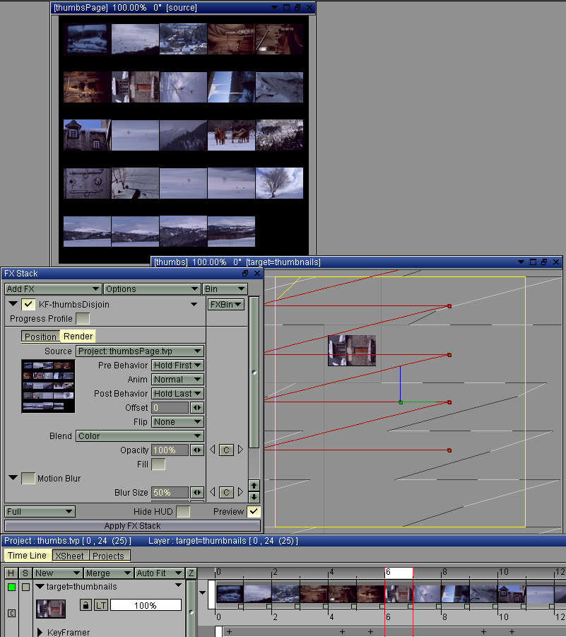

another way to do it is to import the entire .jpg file as a custombrush.
it'll be pretty big but you can use it to
stamp it down for each of the thumbnails, in a project with the right aspect and resolution.

Thanks, sorry I didn't reply earlier, I lost/forgot where the topic I posted was
I have tried the keyframer method and it works to some extent, though it is fairly slow going.

According to your description of "append to layer" scanning, you are aiming to get a 16:9 project, that each frame has a scan of a thumbnail that fills the frame according to your choice of cut.
how about:
1) using the an epson application, scan all images into one folder (if possible, name them sequentialy). I believe that Epson's propriety software does not shut after every scan, and allows you to more easily scan a batch of images. If not, and if you work regularly in this way, maybe it's a good idea to look for a batch scanning application.
2) load all images as a single timeline into a new project (it will be the size of the scans. They should all come up as a sequence.
3) create a new image layer, and make a 16:9 frame in the center of it.
4) in the scans layer go over each frame and pan/transform each image as you like to fit it into the 16:9 frame.
5) once all frames are transformed/aligned in the frame you can crop the project according to the 16:9 frame, and the new project will be the 16:9 and each frame the thumbnail that you wanted.
but in the end, I agree, to lock the rectangle ratio of the cutbrush would be a good feature to have.
