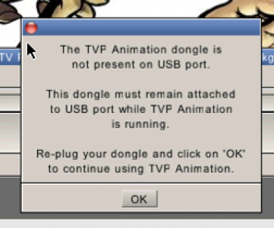

Hi, I have 4 network dongles containing 5 licenses each for TVpaint Animation. I installed the software on 15 Apple G5 computers running OSX. I connected the dongles to a server which all computers can conmnect.
But after install TVpaint just gives me the message "TV Paint dongle is not present on USB Port.
How do I get the sentinel driver or TVpaint to look for the dongles on the network?
