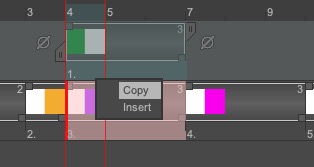

Using INSERT will add the selected frames to the existing timeline , thereby extending the layer length.
Screen Shot 2021-01-10 at 8.18.07 AM.jpg (12.64 KiB) Viewed 31061 times
Using COPY will use the selected frames to overwrite the existing frames on the timeline , and the layer length will stay the same.
Screen Shot 2021-01-10 at 8.18.22 AM.jpg (13.3 KiB) Viewed 31061 times

For the newcomers, with the 11.5.0 you have now different deletion modes that you can configure, as mentioned by David.
By default the v11.5.0 is configured by default to work 'as before' : when you cut or delete, the frames at the right shall move backwards to fill the gap.
You can have preview the deletion modes with a right click in the timeline (Delete from Layer).
I would advise you to try the "stay put" mode for a generic usage, since it never changes the frame positions in the layer.
