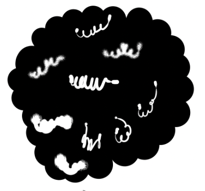

When I am drawing and use the eraser by clicking the button on my pen, it will erase with a big dot at first. It is only after a second or so that the pressure sensitivity will start working. When I stop erasing it will erase a big dot again. I have attached an example of what I mean. It makes it hard to erase precisely. I am using a custom made brush which I have used in a previous Tvpaint version without a problem. I also noticed that it happens with the standard brushes in the program itself.

example of how the brush erases with a dot at the beginning and end of a stroke.

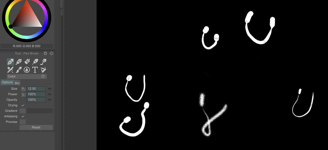

I have tried your suggestion, but unfortunately it does not solve the problem. Could. the problem be, because my computer works with a new chip?

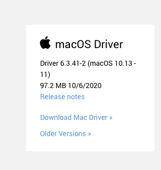

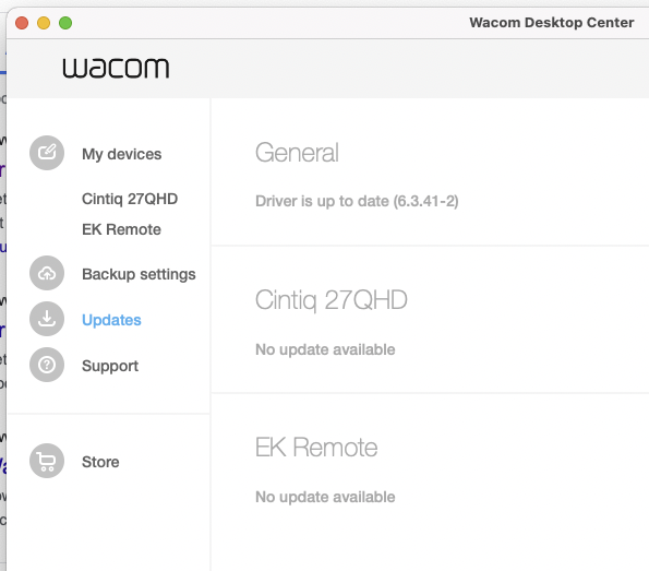

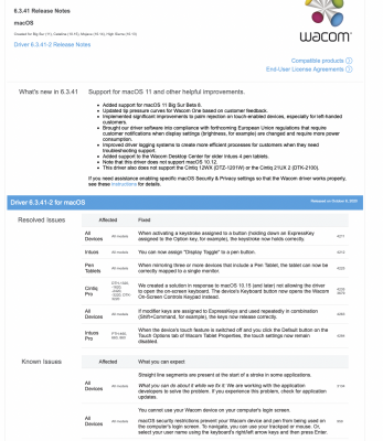

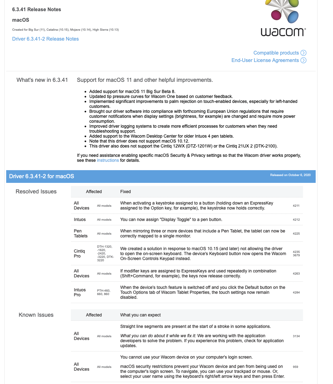

My Cintiq has the latest update which is also made for Big Sur. I have made some screenshots.
Perhaps it is a bug in Tv paint after all? If you need more information about my computer please, let me know.
Thanks!

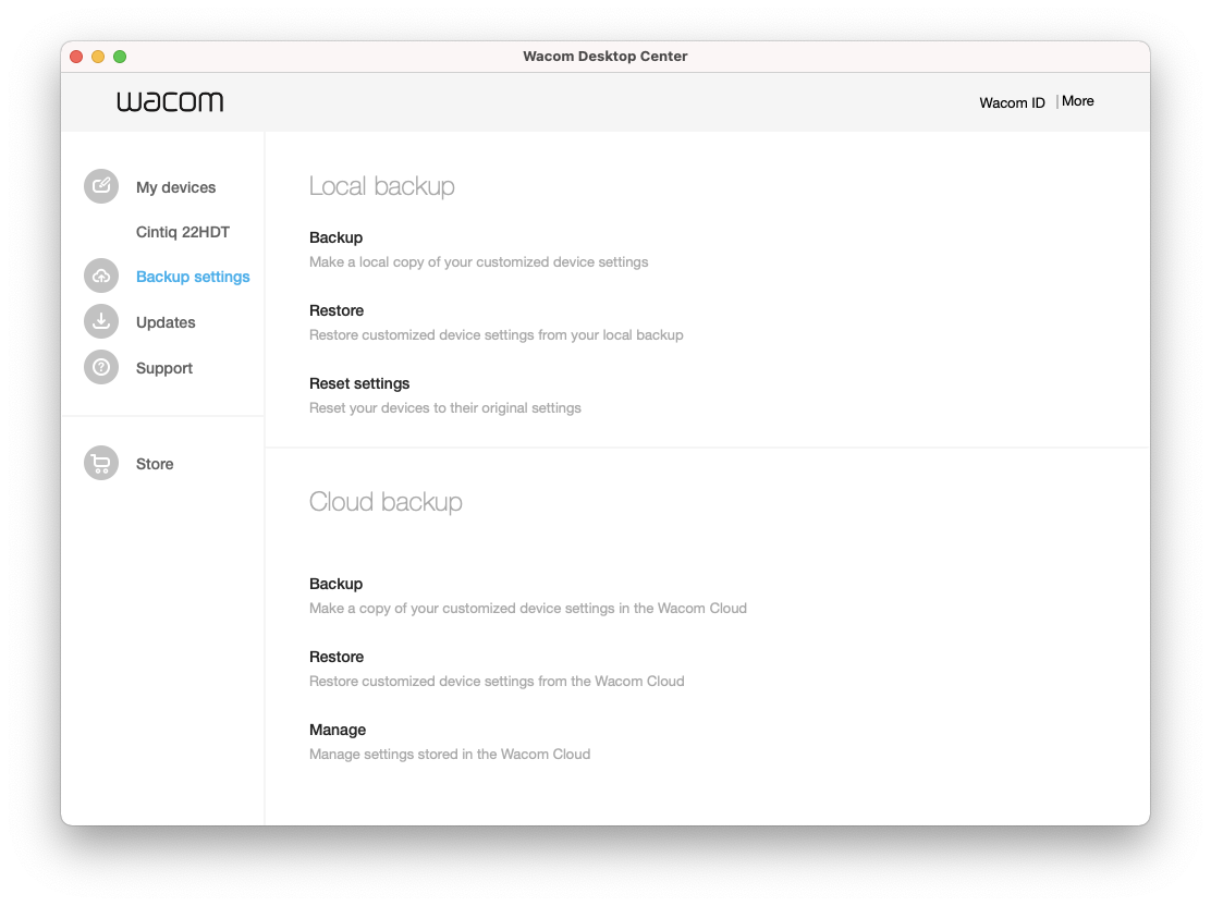

I'm currently trying to reproduce this, without success so far. Given the screenshot you attached, can I assume that you configured your pen to have F4 on the side button ?
If so, it's rather the drawing mode of your current brush that you change to erase, rather than the eraser (the separate brush).
Have you tried resetting your Wacom settings ?
