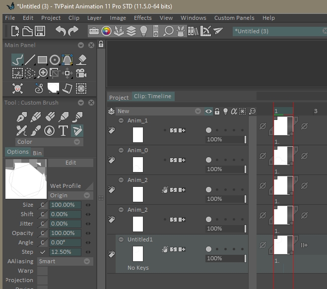

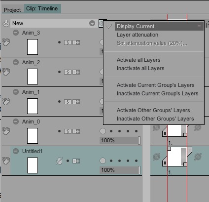

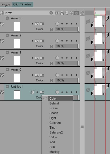

See screen shots. First screen shot shows normal , Display All Layers, with blend modes menu . Second screen shot shows it with Display Current . Display Current has no blend modes menu showing. (third screen shot shows TVPaint 11)
However , it must be pointed out that this is NEW in 11.5 . Previously in version 11 choosing Display Current still had the blend modes menu visible. I don't know why this was changed (and if only TVPaint developers know it was changed then it will be a source of confusion to many users ! ) Xavier, what was the reason for changing this ?
TVPaint 11.5 -
Screen Shot 2020-11-29 at 8.50.12 AM.jpg (43.79 KiB) Viewed 8445 times
TVPaint 11.5 -
Screen Shot 2020-11-29 at 8.52.02 AM.jpg (42.21 KiB) Viewed 8445 times

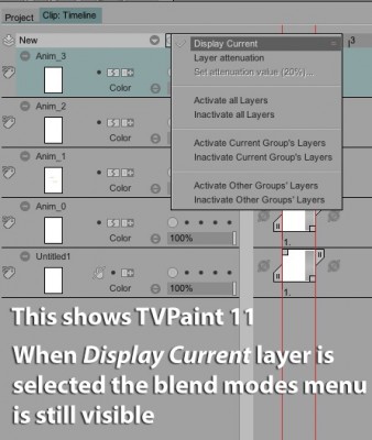

This is TVPaint 11 - when the Display Current layer is selected the blend modes menu is still available.
