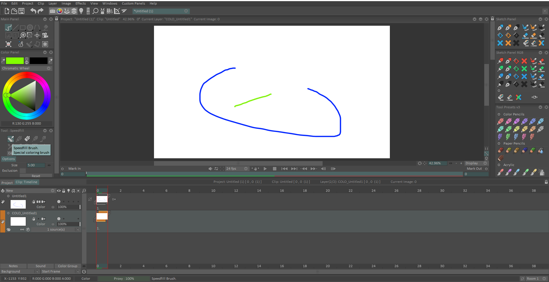

Hello. I recently purchased TV Paint 11 Pro. My iMac computer is OS 10.15.6 Catalina with 32GB of memory, one terabyte of SSD storage, and 4K resolution. My Wacom Cintiq Pro 24 has 4K resolution. My Cintiq and my iMac are completely new and dedicated solely to my TV Paint 11 Pro. I have been unable to get the Speedfill tool to fill in colors. Example: I made some line drawings on one horizontal row in the Timeline, and then clicked on "New" in the Timeline, prompting a pop-up box of selections, and selected "Colo & Texture Layer", which added a new horizontal row below my row of line drawings. This deactivates the Paint Bucket, but adds a new icon called Speedfill. Then, with the Speedfill icon selected, I selected a color and then moved my mouse or stylus to my line drawing and marked an area in it, but the space did not fill with color. Instead, each time I just got a color line accented with tiny checkerboard squares, and I tried this many times. Is there another step I need to take to activate Speedfill to fill the enclosed area in my line drawing?

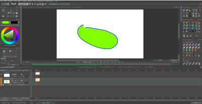

No there ain't, you are doing this correctly it seems.
But bear in mind the shape should be "closed enough" for the speedfill function to work properly (example below).
Please have some more tries at it, and if you still encounter any difficulties let us know. We will assist.

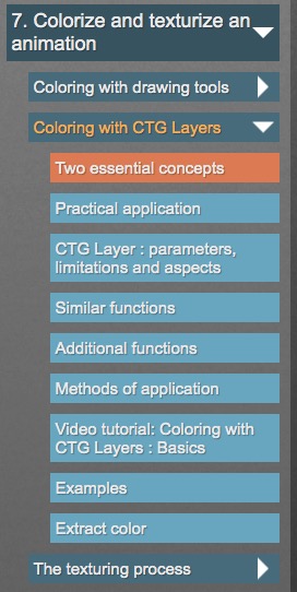

You should look at each section in Chapter 7 of the User Manual:
7.) Colorize and Texturize and Animation
TVP User Manual_Coloring.jpg (52.06 KiB) Viewed 8284 times

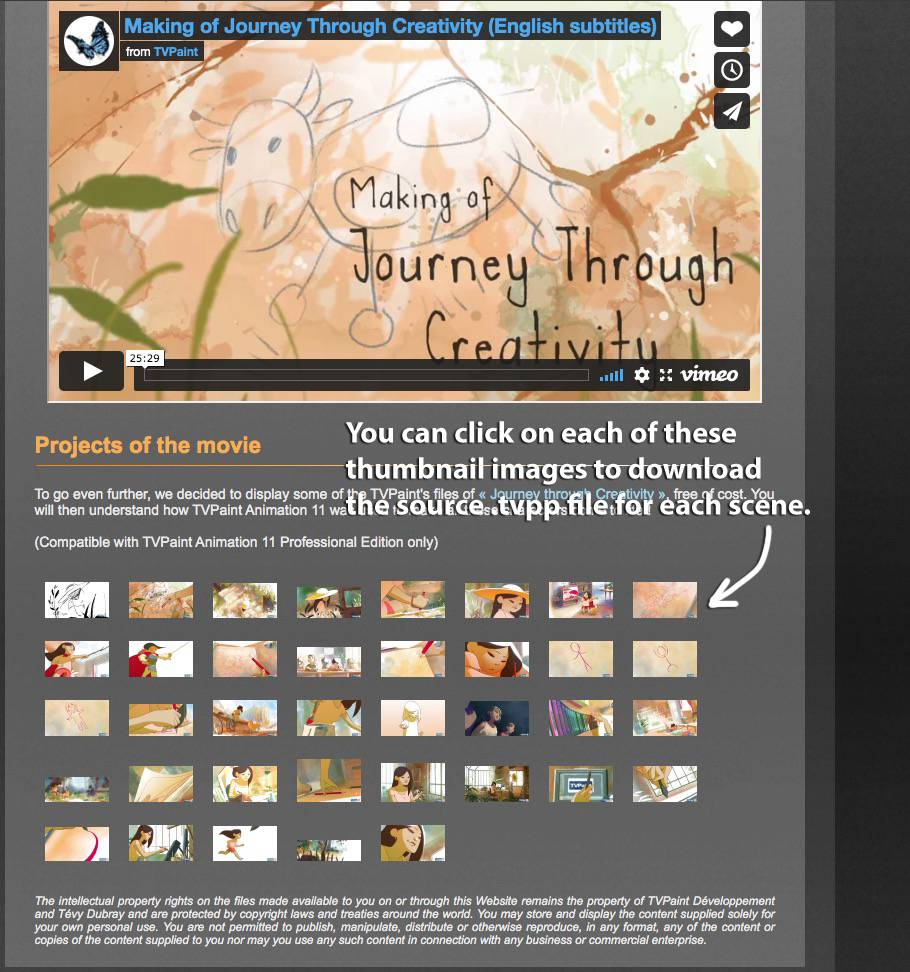

You can find some .tvpp source files to practice with here : Contents and Examples (there is a download link on that page to download the source files)
More TVPaint source files are available here (scroll down to the bottom of the page ... each of the thumbnail images is a link to download a source file ) -
https://www.tvpaint.com/v2/content/arti ... tivity.php
On that page you can watch the film "Journey Through Creativity" made entirely in TVPaint , and watch the "Making-of Journey Through Creativity" which shows the various techniques and tools used in the making of the film. The source .tvpp files are useful, because you can download them and open them up in TVPaint on your computer , to see how the layers are ordered , how the various colorization effects and other effects are applied.
