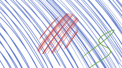

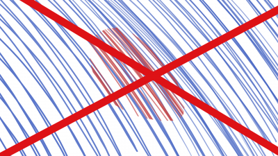

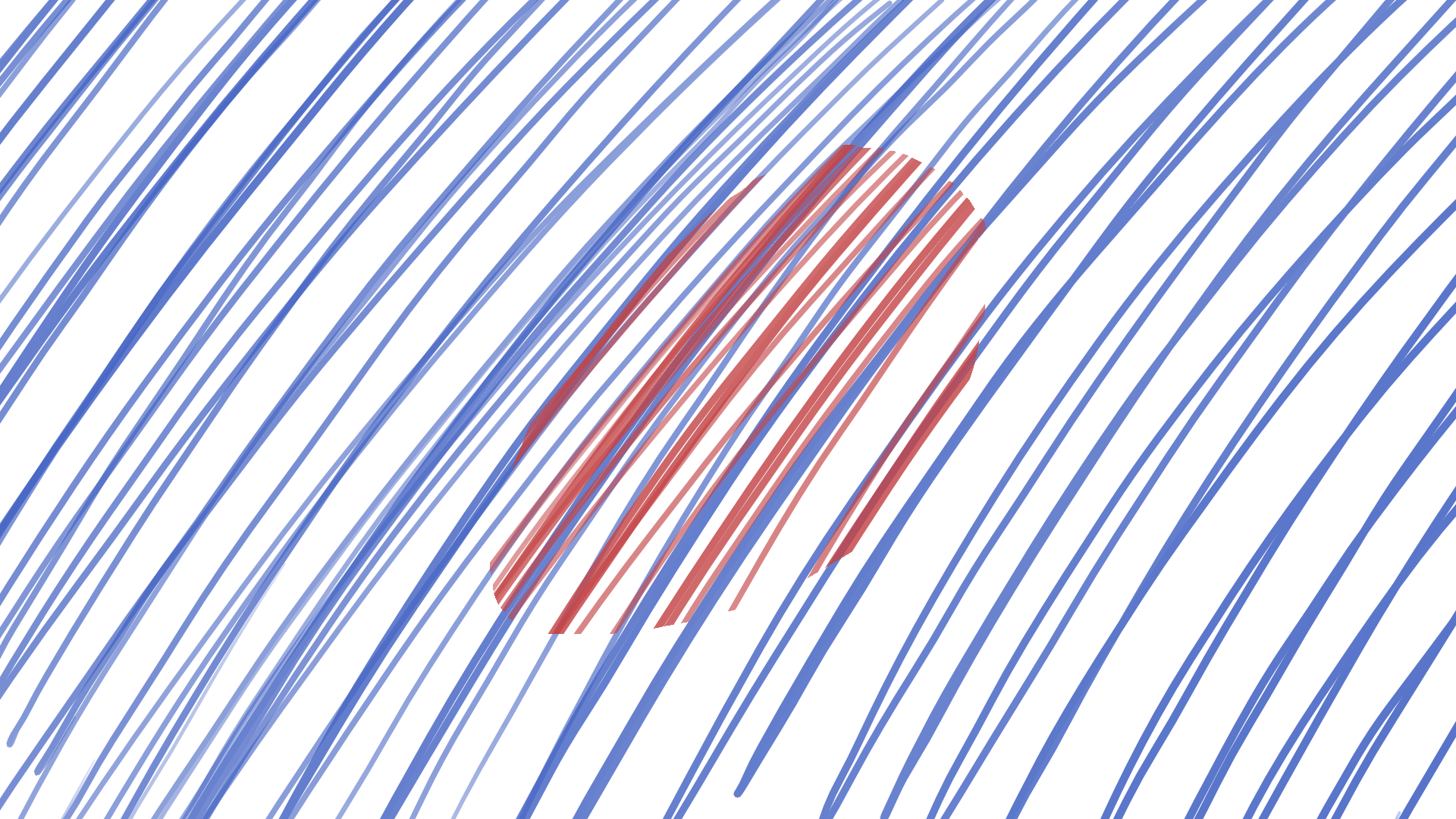

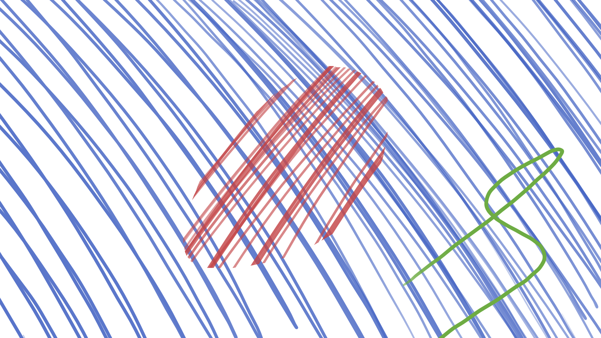

Xavier wrote: 17 Sep 2020, 16:58 Hi, again, could you please tell me the steps to reproduce this ?
artwork
custom brush tool (red lines)
now a flip horizontal also flips the tool... no good!
we like to keep our tool the way it was! yes!
