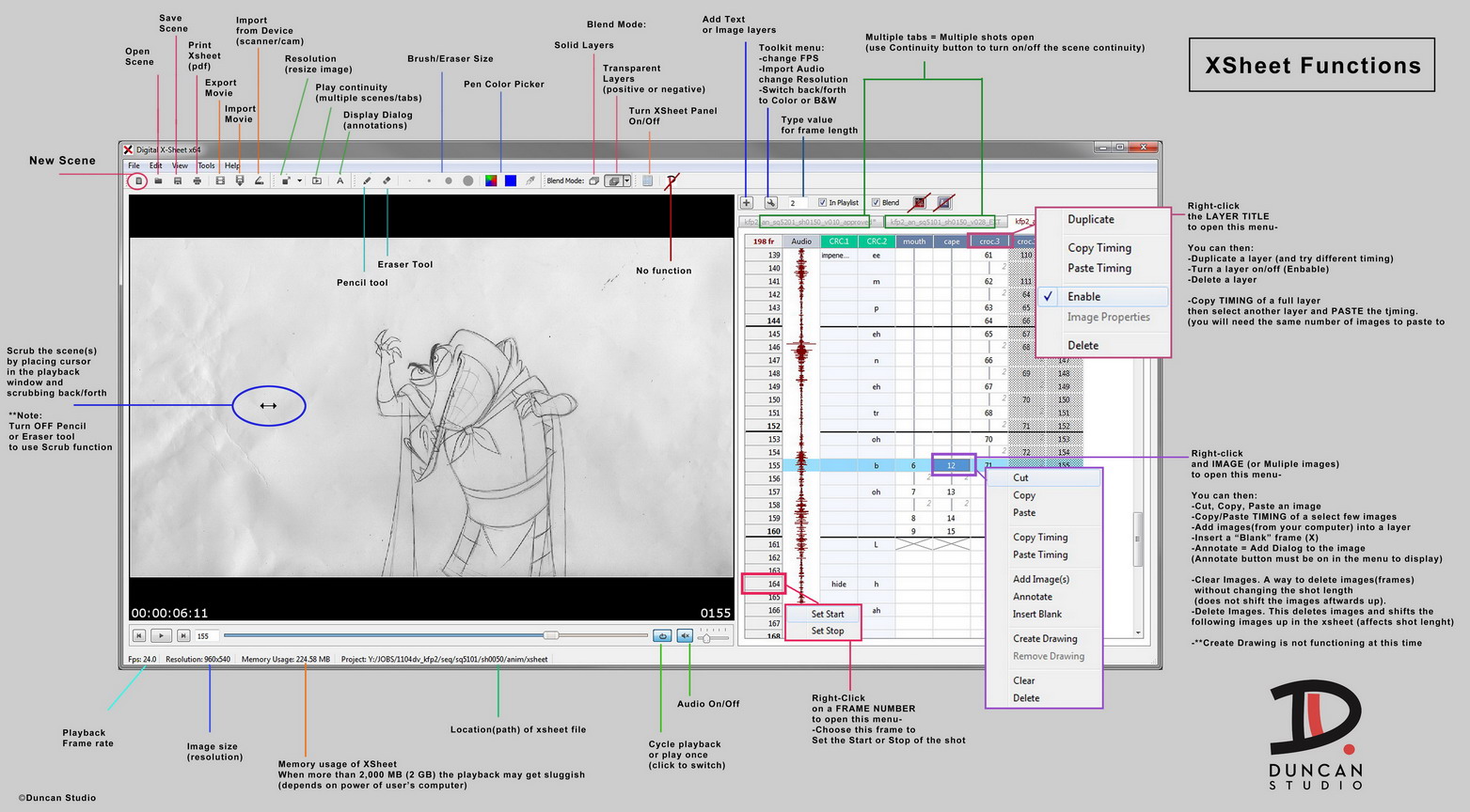

Re: exporting for finishing of in other software?
That looks neat however I coudln't see any of the demo videosD.T. Nethery wrote: ↑11 Jun 2020, 17:44See:
https://www.facebook.com/photo.php?fbid ... =3&theater
I was wondering what's the approach for it. On the surface it looks like keyframe pro + an xsheet right?
Have you been able to try it D.T.?
When it comes to the Toei Xsheet it's free to download and use, the exchange format is also text editable so you can script it to match your needs. I wonder if Duncan's xsheet has export options.

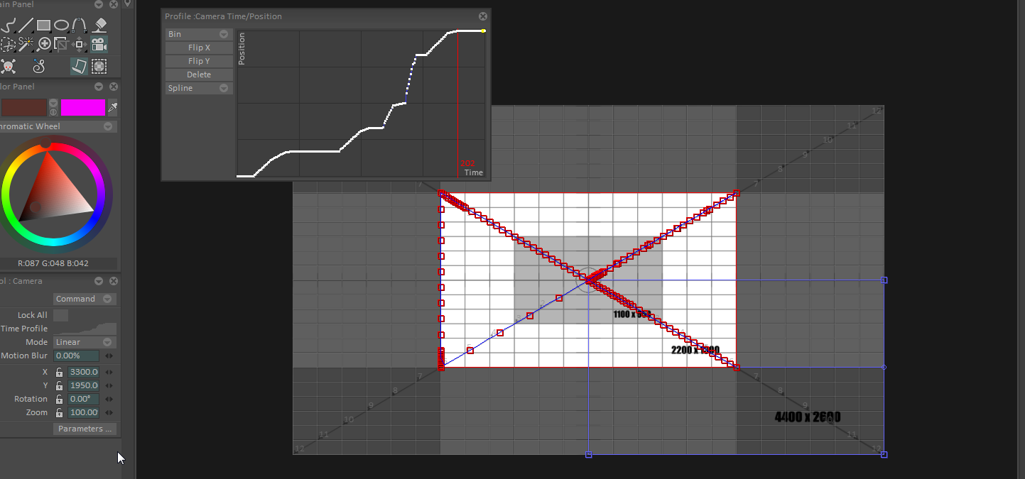

Whoever has worked with tvpaint cameras, will find this image beautiful!
www.cocoalopez.com
I wish I had those skills!!!
We're writing a camera data mapper to export camera information from Maya to Tvpaint though we're having some issues with the speed calculation. By any chance is there any documentation on TVpaint cameras?

In my humble opinion- The very best linetest software on the market. Easy to understand and easy to use. Very strong! No crash!!D.T. Nethery wrote: ↑11 Jun 2020, 17:44
Duncan Studio developed an X-Sheet application for their own use on both CG and traditional hand drawn projects . They're considering marketing it .
Ken Duncan mentioned in the discussion: "A very good animator who works in TVPaint, and who has worked with our X-sheet, wondered if we had the tool available so he could time stuff out better. So...it could be used in several ways. We had intended to market it several years ago...but life got in the way. We did make a "home" version that expires in 30 days...
We'll probably revisit the "selling" of it. "
See:
