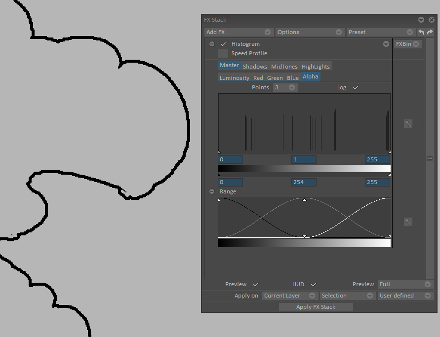

I have no idea whether I selected the correct FX regarding the term "threshold", but I've managed to get it to work by using the following:
FX: Border > Not
FX: Histogram - Alpha > Midtone top set to 1 and Midtone bottom set to 254.
If this wasn't what you meant, could you please elaborate further and lend me your guidance to where I can find threshold for next time?

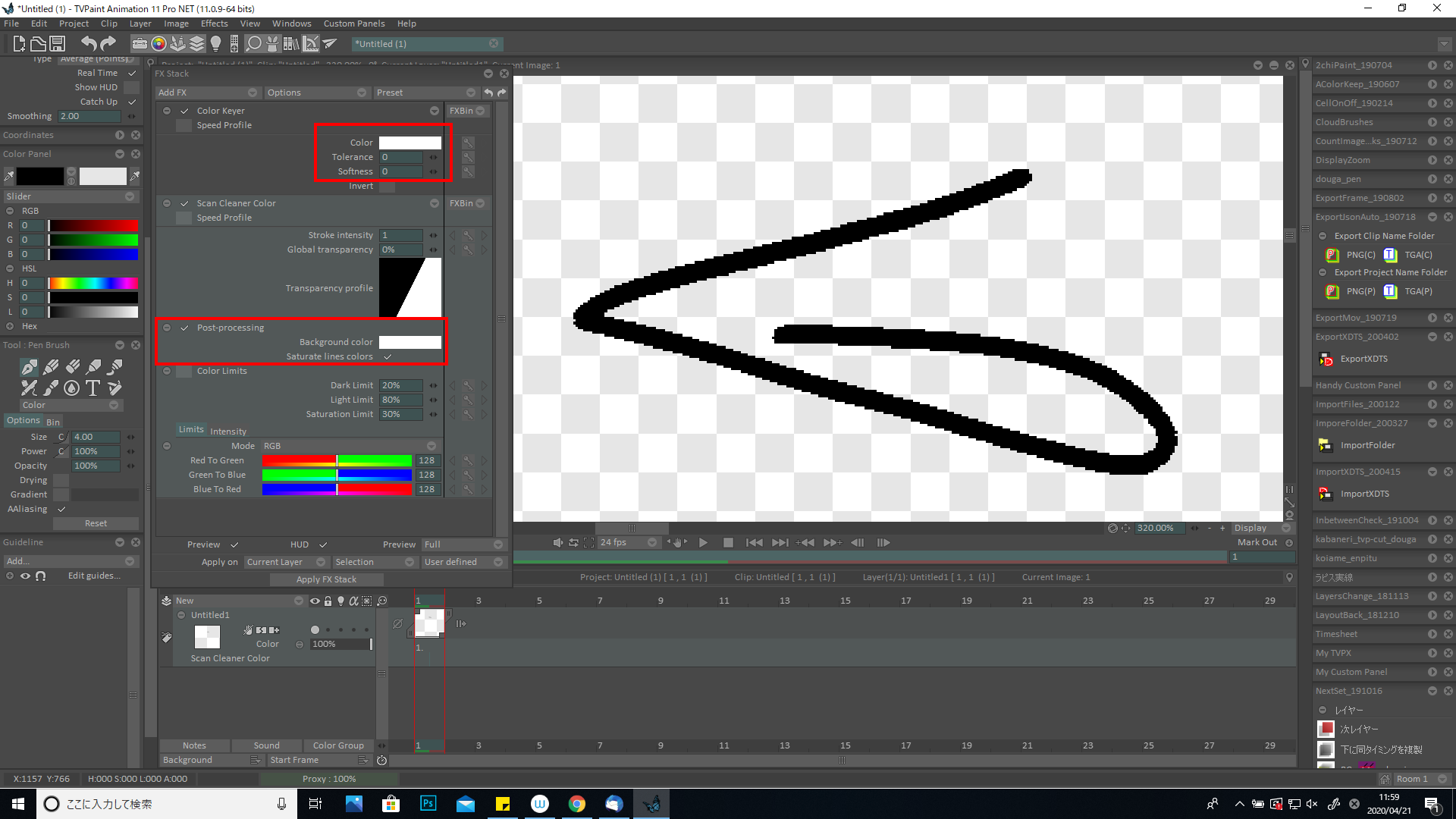

In Japan, work to turn off anti-aliasing for Paint is done every day, and I asked TVPaint to add that function with "Scan cleaner: color" FX.
This FX is based on paper material. The original purpose is to work on an image with a white background and adjust the extraction with Stroke Intensity.
Please check the image below. I hope your goals match.
