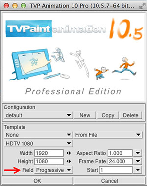

is your project maybe set to field: upper/lower ?
It should always be set to Progressive
- Posts: 4269
Re: pixelated lines
Peter beat me to it. I was going to say the same thing .Peter Wassink wrote:is your project maybe set to field: upper/lower ?
In the Startup Panel, make sure that Field is set to Progressive . (not upper first or lower first)
- Posts: 3
- Joined: 29 Oct 2014, 03:30
Re: pixelated lines
Hi thanks yes it is already set to progressive.
