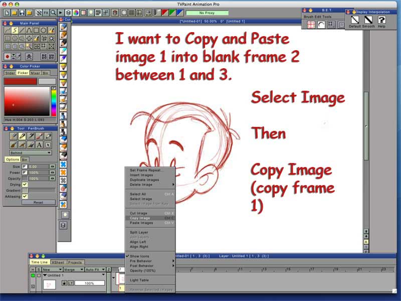

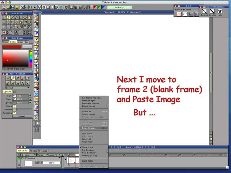

Sometimes I simply want to Copy (ctrl C) a frame and Paste it (ctrl V) to another blank frame between two drawings.

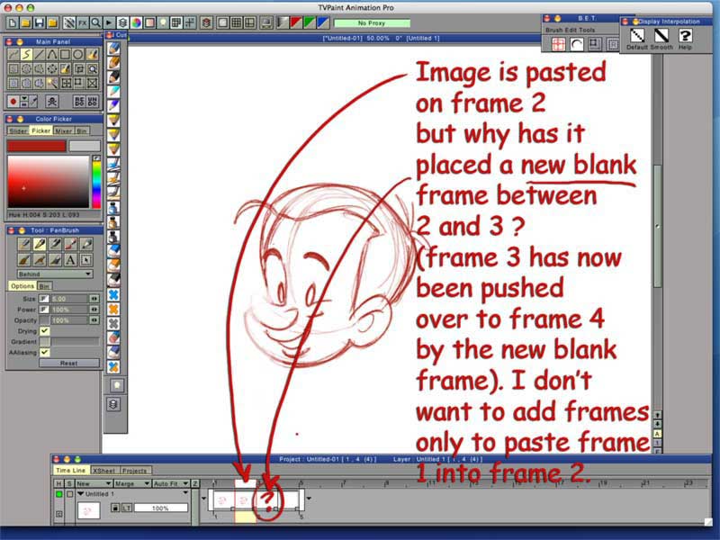

An odd thing happens ... When I paste the copied image it pastes a new blank frame inbetween the pasted image and the next image. Then I have to manually delete the new blank frame. I don't want an extra blank frame inserted , I only want to copy and paste the one frame.
(See attached images as explanation)
Why is it that when I 'Select Image' and 'Copy Image' (frame 1) and them 'Paste Image' to a blank frame (frame 2) that TVPaint creates a new blank frame between frame 2 and former frame 3 (now pushed forward one frame to become frame 4) ?

to paste over you need to select the frame(s) you want to be pasting over.
this way any selection of frames you make can be replaced (pasted over) with whatever your currently copied frame selection is.
quite versatile.

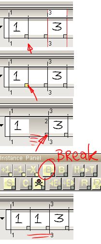

but another way to fill up an empty inbetween with the image of the previous frame is to drag the instance handle while holding the CTRL button.
this will keep all following instances in position and 'overwrite' the empty frame with the tail of the preceding instance head.
see image:

Tantalus wrote:to paste over you need to select the frame(s) you want to be pasting over.
Thank you , Peter. That did it ! Now I understand.
see image
Yes, there is that method and I probably should simply stick to that , but old force-of-habit from other applications I use makes me almost automatically do it with ctrl C and ctrl V .

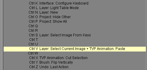

in your specific case, you can also modify your [ctrl+v] shortkey as in te pict. below :
assign [layer: select current image] in first, then ctrl + assign the Paste command. 8)
