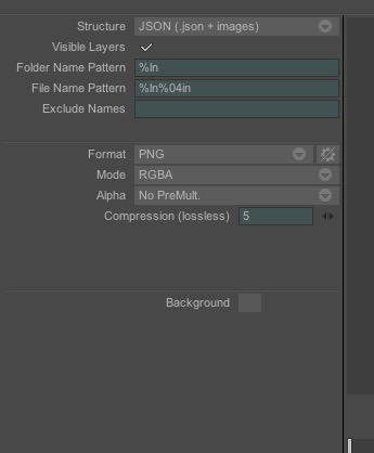

Re: Json + repeat images
Look here in the user manual:
https://www.tvpaint.com/doc/tvp11/index ... xport-json
This tutorial :
https://www.youtube.com/watch?v=YayOsWHXQZo
In your TVPaint folder there should be a script called AfterEffects Import TVPaint JSON.jsx which you will use to bring the exported layers from TVPaint into After Effects.
The most confusing part to me was learning to set the File Name and Folder Name. These settings work well for me:
Folder: %ln (this sets each image folder to the layer name)
File: %ln%04in ( this sets each image file name to the layer name + instance name with 4 digit numbers)
Screen Shot 2019-06-05 at 7.27.09 AM.jpg (19.63 KiB) Viewed 18394 times

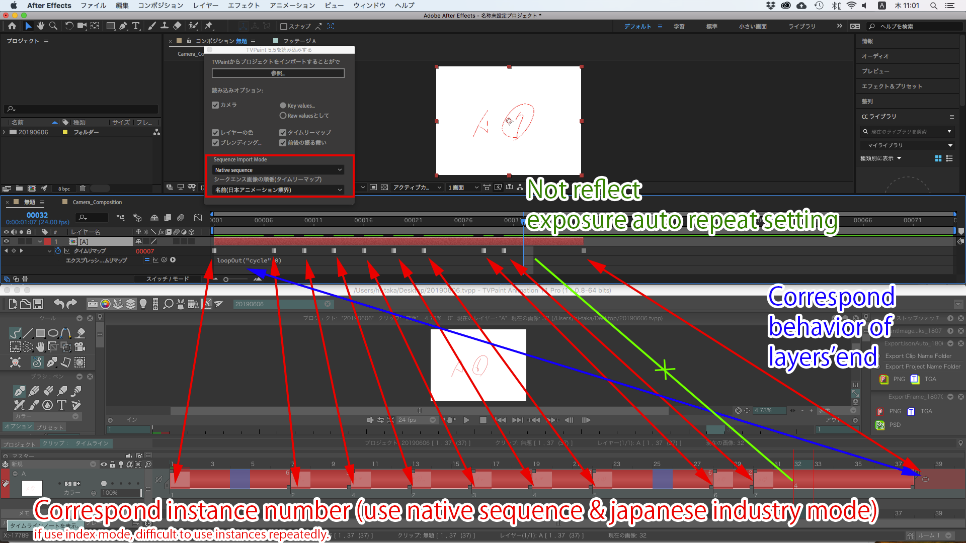

Post by Hironori Takagi »
As I am involved in the function request of JSON + image export, I will answer.
In order to use the image repeatedly, it is necessary to set the instance number, and the repeat setting of the exposure can not be used.
This is because the way of making in Japan is often more complicated than simple repetition.
As we summarized in image about method and contents to be reflected, please confirm.
(Sorry for the automatic translation in English.)

Post by suneda »
ありがとう!それを探してました。
Thank you for your replies. That is indeed what I was struggling with. I guess I should look for a fast way to convert my repeated images to instances.
