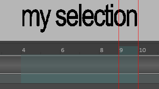

If you make a selection of one or several images, your text will fit the selection.
my selection.png (3.41 KiB) Viewed 22057 times

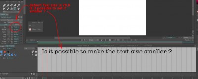

Is it possible to make the text size smaller ?

D.T. Nethery wrote: 16 Aug 2018, 12:32
Hey, D.T! This worked for me.
Right Click on the icon
Hit the drop down menu on line zero and select "Embedded George Script"
You can change the font size here
OR, the following change will make the tool a bit more flexible I think. This will make it so the text tool is not changed to the parameters specified in the original code. So the settings you had before you activated the function will persist.
It even retains many of the parameters from the text tool like border, glow, and angle.
