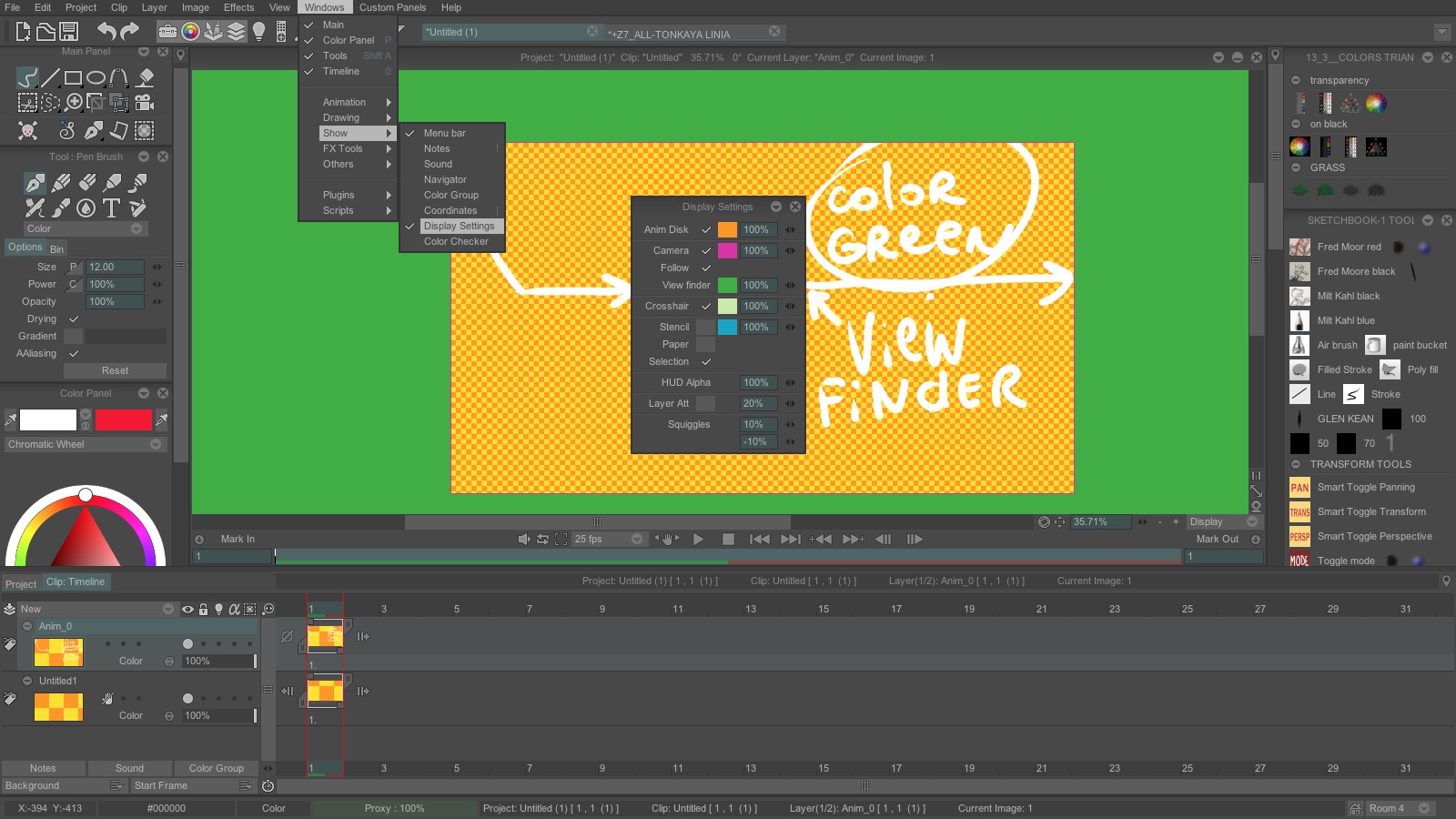

Animationriver
Posts: 258
Joined: 02 Jul 2017, 09:04
Location: Moscow
Re: Background > None, Colour and Check
Post by Animationriver »
:D
