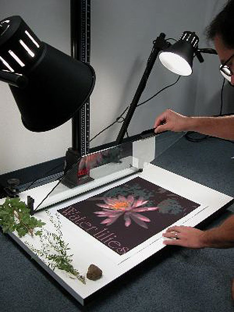

Finally I would like to ask if someone has ever tried snapping the pegged artwork with a high quality digital camera and then import it into TVPaint
for coloring etc...I remember reading a thread that someone was doing this on the TVPaint7 forums...
I would like to know that answer to that question, too.
I imagine it would work fine if you had the correct equipment (copystand, lights, pegbar)
It is still fairly easy to find good quality copy stands with lights to mount a digital camera on; then it's simply a matter to add a carefully aligned metal peg bar to the base of the copy stand to hold the drawings in registration.
The most important thing is to find a copy stand with a glass platen attachment (optically pure glass) which will be used to press down on the drawings so that any folds or wrinkles on the surface of the paper will be flattened out and not captured by the camera when an exposure is taken.

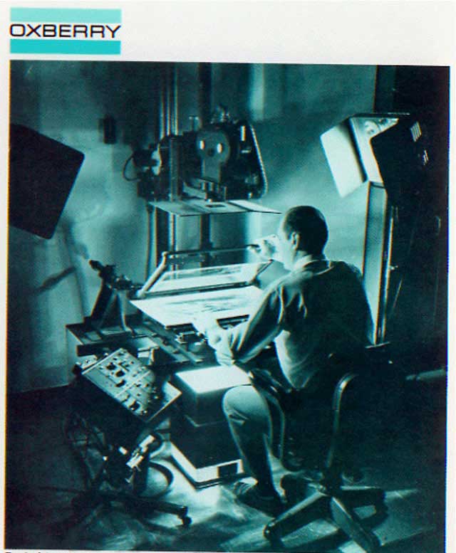

It would not be as fast as using an Auto Document Feed scanner, but still not quite as cumbersome as the old days shooting on an Oxberry camera rig .
