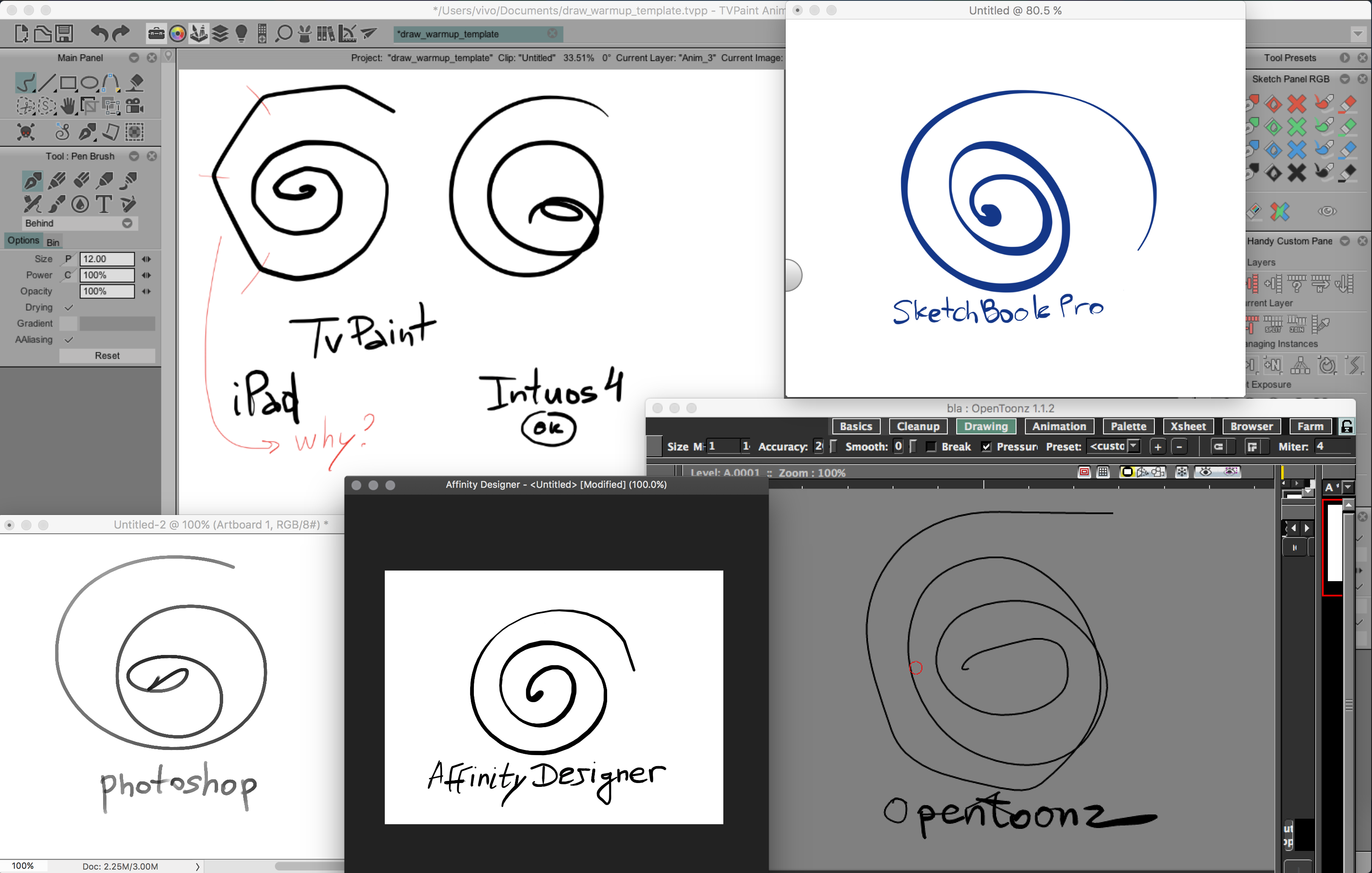

I have set up an iPad Pro with Apple Pencil connected to a mac with USB using the Astropad app.
Everything works quite well except when I try to draw quick curved strokes.
They appear angular and spiky (see the attached screenshot).
This appears only when drawing with rather quick strokes.
Other software seems to deal well with the same kind of strokes.
No problem in Photoshop, Affinity Designer, SketchBookPro and almost good in OpenToonz.
Also just fine is when trying the same with Wacom Intuos 4 (Driver 6.3.22-3).

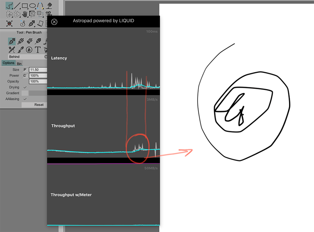

What bothers me most and makes me think this is a TVPaint bug is that other software behaves just fine.
By the way you can see some measurement of latency and throughput from Astropad in the attached screenshot.
