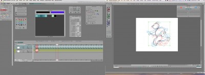

Simply detach and move the drawing/camera/project area so it's centered on the screen where you want to draw.o0Ampy0o wrote:That places the physical gap and both display's frame down the center of the drawing/camera/project scene area.
How do you get around that?
In this example I have my drawing area on one monitor (Cintiq) with the Light Table and a Pencil Tools panel . All the other panels such as the Timeline , Tools, etc. are on the other monitor (Macbook Pro).

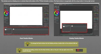

Double-click on the Timeline window's title bar at the top (not on the Timeline itself , but along the top edge of the window) to detach it to be a floating window.lapprenti roi des singes wrote: ↑16 Mar 2017, 21:04
I remember I could detach the timeline as well to make it an independent window that I could keep only in my first monitor, but I can't seem to do it anymore in the 11 version (it just drags along on both monitors, which is a bit tricky to handle, since I work with a Wacom Intuos and map my tablet on one monitor only).
Or is it a different method to do it (I remember it was click and drag the head of the timeline before, but maybe it changed here) ?
https://www.tvpaint.com/doc/tvp11/index ... exceptions
