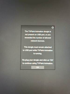

I have a new M4 Mac Mini and am running OS 15.4.1 Sequoia. I'm having an issue with TVP 11.7.0 in that it brings up the attached screen prompt, and when I click on "OK" it immediately shuts down the app.
I've tried replugging the dongle, but it's still not working.
Can you help me?
-Bruce
Posts: 1150
Re: TVP crashing with Mac OS 15.4.1
Hello BruceM, this is normal since Monterey and the MacOS versions that came after are not compatible with the dongle's Sentinel driver.
Please create a support request from the contact form on our website to have your license migrated to dongleless (it is free).
