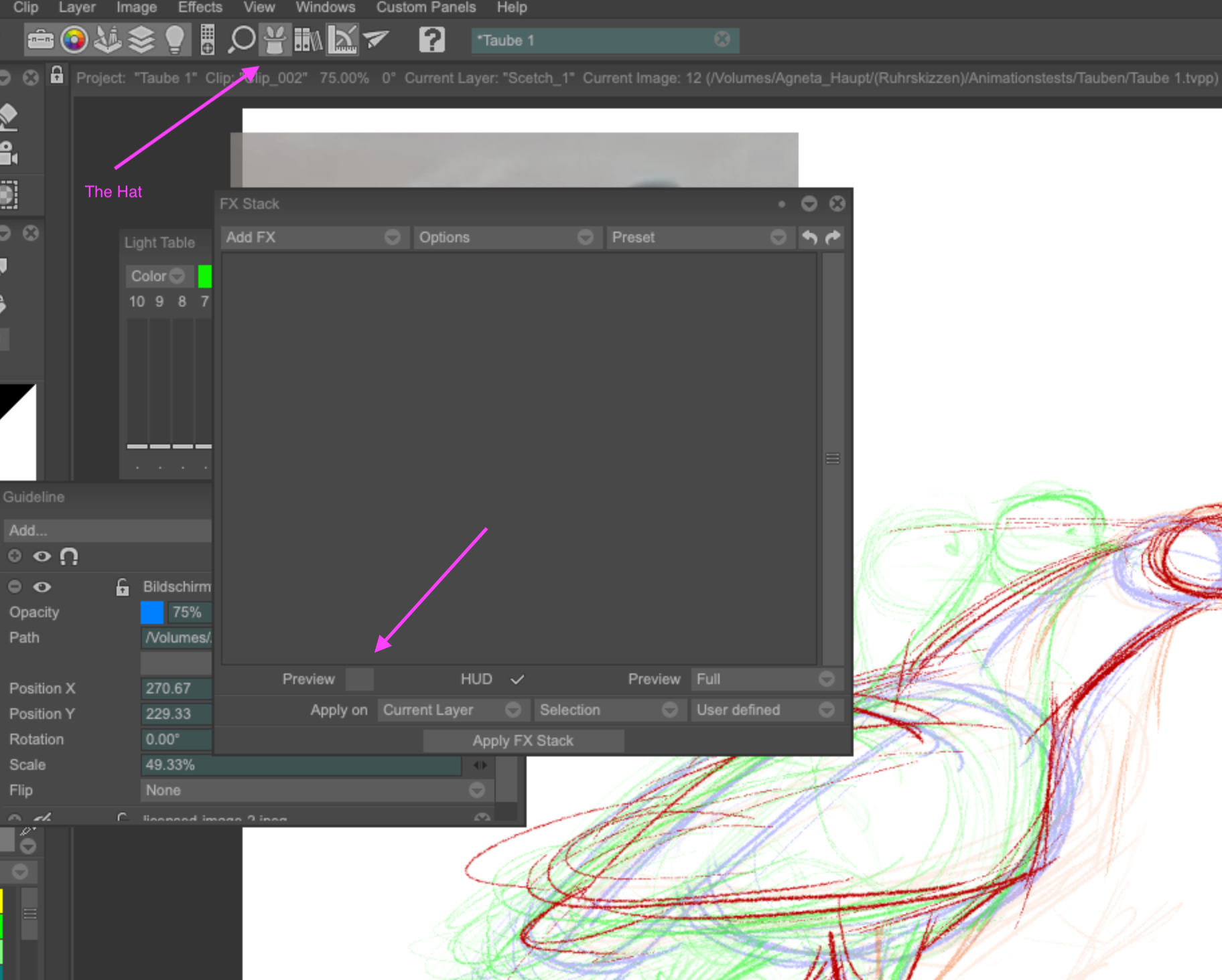

Hello Agneta, this is a bug we are currently fixing.
Unticking the Preview square in the FX menu (upside down hat icon in the top tool bar) will fix the issue.

Thank you very much, Dean!
the workaround works well!
here is the screenshot for those having same issue:
