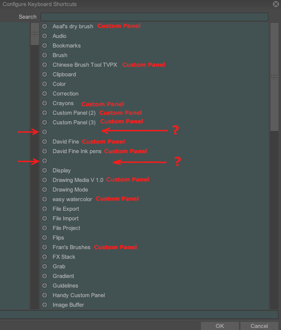

Re: Shortcuts bug?
I am on Mac OS Mojave. I see my Custom Panels in the Shortcuts List , but I also see gaps in the list . I don't know if the gaps are Custom Panels that have somehow been turned "invisible" in the list or if those are older Custom Panels that I have deleted . Either way, I expect there should not be gaps in the list , so this seems to point to an issue with the Shortcuts List.

Since I still got this problem on Windows and Android (TVPaint 11.7.0). I searched for this topic again and Davids post was part of the solution:
I named a custom panel : : : : : : : : : : : : : : : : : : : : : : : : : : : : : : : : : : : : : : : : : : : : : : : : : : : : : : : : : : : : : : : : : : : : : : : : : : : : : : : : : : : : : : : : : : : : : : : : :, cause I didn't need a name for it and this way it looked nice.
But this was the issue. After renaming it to "Custom Panel" the error disappeared. Maybe something to fix? If not maybe a help for somebody else.
