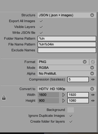

I’m an animation student working on my graduation film and I’ve encountered a problem when exporting my animations with JSON (PNG + RGBA).
If I open the exported folder, all the PNGs for my clean up lines are there but for every single colour layer, there is just 1 blank PNG.
I am confused because back in March I exported other shots with the exact same method (following the official TvPaint tutorial on Youtube) and the same TvPaint version and I did not have this problem. I tried reexporting those shots today and it doesn't work for them either.
The colours do appear however if I export my layers as one PNG sequence or a video file. The issue seems to be specific to JSON.
I tried updating TvPaint but the problem remains.
You can see my export settings in my attached file.

JSON fails to export colour layers Topic is solved

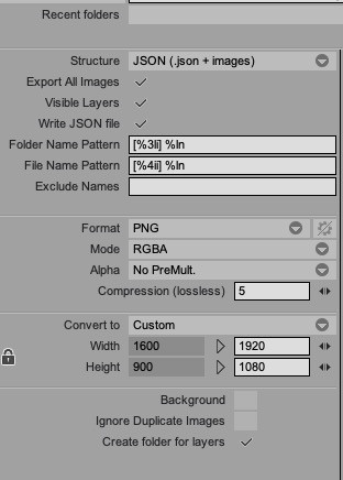

Try these settings to see if they give better results:
Folder Name Pattern: %ln
File Name Pattern: %ln%04in
You may also want to try changing the image format to TGA , RGBA .
Re: JSON fails to export colour layers
Hello D.T. Nethery,
Thank you for your reply; I tested all the settings you suggested but I still get the same results, sadly.
If I uncheck "ignore Duplicate Images" however, the right number of PNGs are exported for my colour layers, although they remain blank.

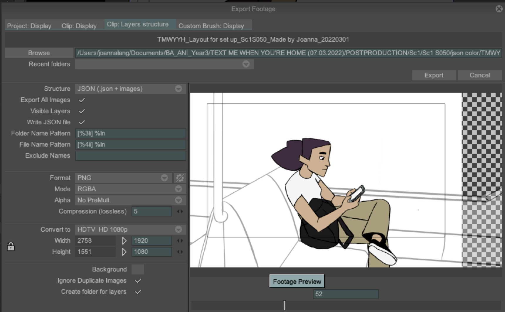

Hello Joanna, the problem comes from the fact that your project is exported in dimensions different from the one you created it with (from 2758*1551 to 1080p), making the CTG layers' squiggles displaced and creating anomalies.
The easiest solution might be extracting the CTG layer's colors as bitmap layers (using the paint palette icon on their heads in the layer list) before exporting.
You can also resize your project before exporting it, but this might require a couple small adjustments with your CTGs' squiggles.
It must be hard for TVPaint to decide where the squiggles should be moved when there is less space on the workspace overall, I will see with the devs if they can add a warning message about this.
