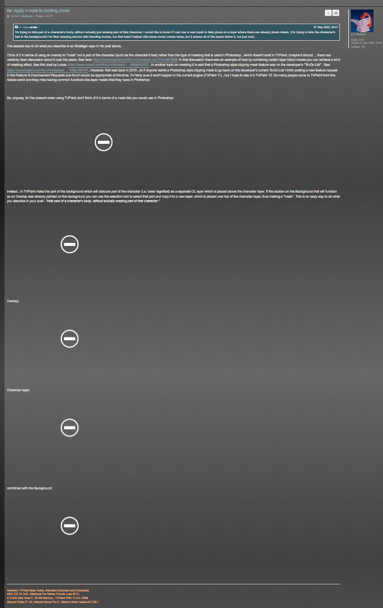

David, i can't see your images,
in my browser your post looks like this:
Posts: 4272
Re: Apply a mask to existing pixels
Peter Wassink wrote: 09 May 2022, 19:09 David, i can't see your images,
Thanks for letting me know , Peter. I could see the images earlier when I posted them , but now I can see they are not showing up. Weird. I'll edit the post and repost the images from a different image sharing site.
UPDATE: ok, I re-posted the images above. Do they show up now ?
