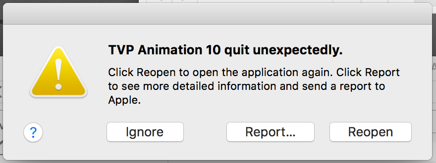

It simply will not start up and I get the message "TVP Animation 10 quit unexpectedly" with the option to "Ignore", "Report..." or "Reopen".
Screen Shot 2022-02-07 at 21.33.47.png (63.92 KiB) Viewed 5356 times
When I select "Ignore", the software won't open and for, "Reopen" I get the same "TVP Animation 10 quit unexpectedly" message again.

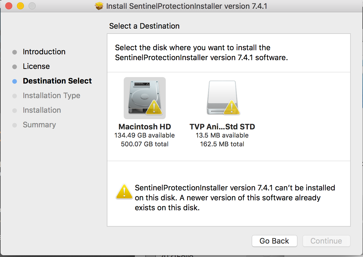

When reinstalling, I was unable to install SentinelProtectionInstaller 7.4.1 due to "A newer version of this software already exists on the disk".
I can see that I have SentinelProtectionInstaller 7.4.2 on my computer, but I don't seem to be able to uninstall this.
