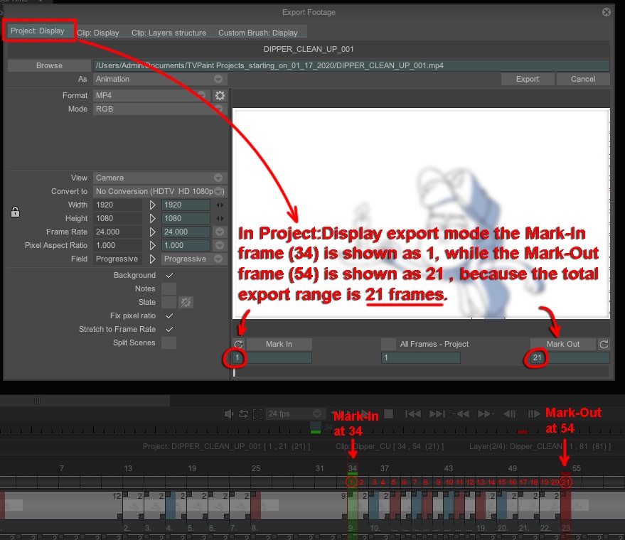

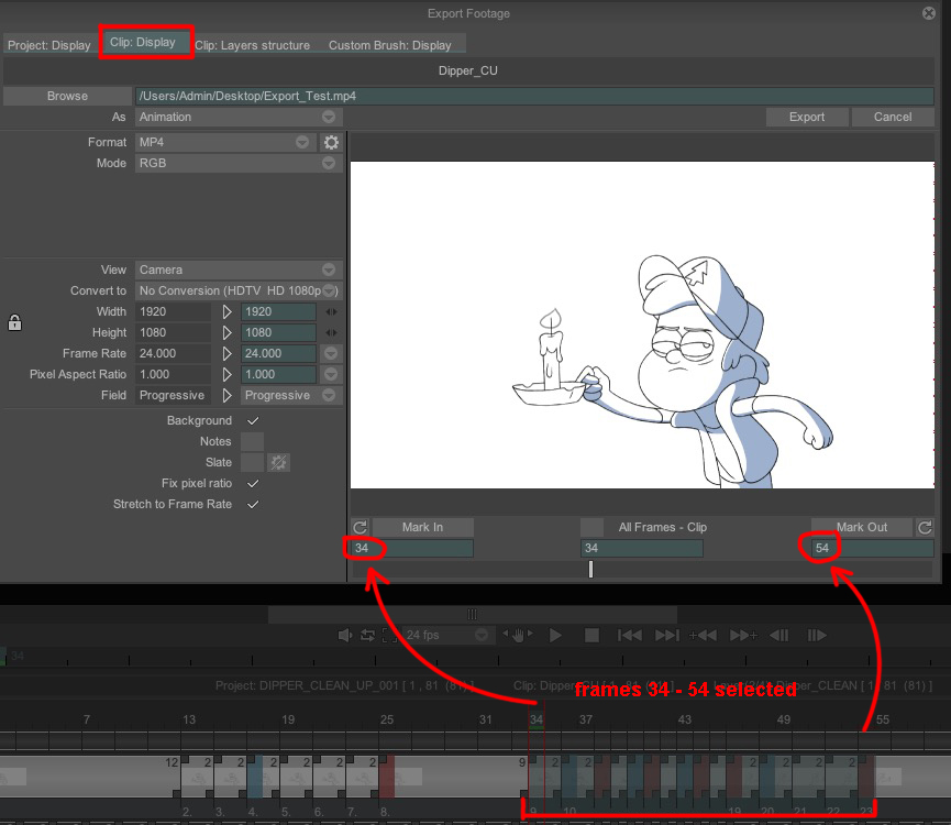

In 11.5.2 if I select a range of frames (in this case 34 to 54) and Export from the Clip:display tab it will only export the selected frames , 34 - 54 .
However, it looks different if exporting from Project:display tab . In Project:display it will export a range of frames that have Mark-IN and Mark-OUT markers applied (in this case , Mark-In at 34 , and Mark-Out at 54). But in the Project:display export window it shows the Mark-In frame (34) as "1" and the Mark-Out frame (54) as "21" because the total range of frames to export is 21 frames.

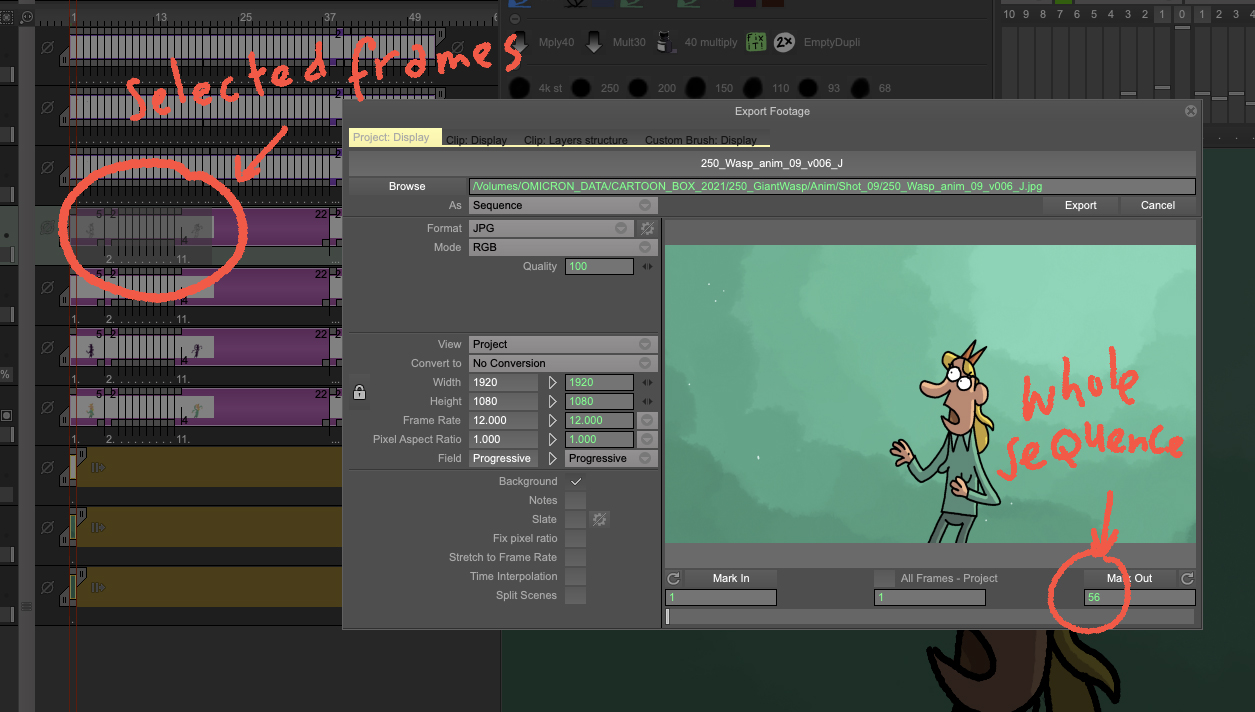

Example:
TVP Pro 11.7.1

Joost wrote: 14 Jul 2021, 11:59 Example:
In your screen shot it shows you are trying to export from the Project:Display tab. To do what you are attempting to do you need to export from the Clip:Display tab.
See my post above with the two screenshots showing export of selected frames from the Clip:Display tab and from the Project:Display tab. They function differently. Use the Clip:Display tab to export your selected frames. (If you export from Project:Display then you must set a Mark-In point and Mark-Out point so only the frames in the Mark-In/Mark-Out range are exported.)

D.T. Nethery wrote: 14 Jul 2021, 14:53 In your screen shot it shows you are trying to export from the Project:Display tab. To do what you are attempting to do you need to export from the Clip:Display tab.
I double-checked it in TVPaint 10.5.7 . It's the same behavior in TVPaint 10.5.7 . To export only selected frames you must export from the Clip:Display tab. In TVPaint 10 using the Project:Display tab you must manually set the Mark-In and Mark-Out flags on the timeline to have only that range of frames exported.
No way! I feel soo stupid!
That's how I always used to render. I totally missed that check mark over there. I only noticed this mark at the Project:display tab.
Sorry for all the inconvenience and thanks for all the help and effort!
